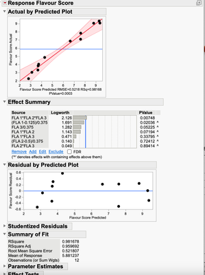

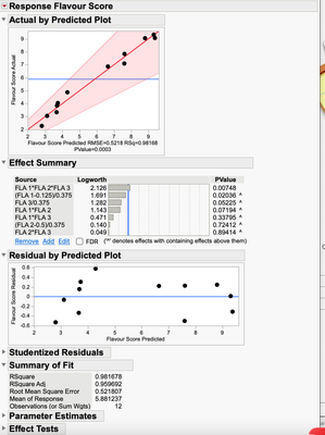

Did something in JMP 18 change in analysis of mixture experiment results. Below is shown that analysis results from exactly the same DOE data sets are different
1. DOE three component mixture
JMP 17 results
JMP 18 Results

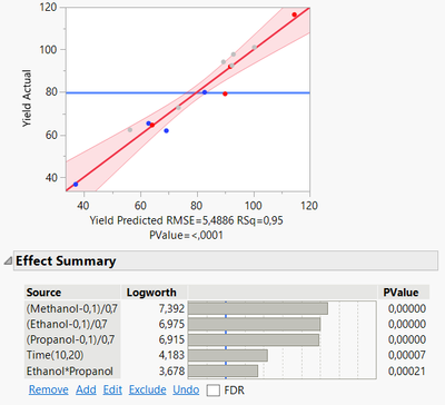

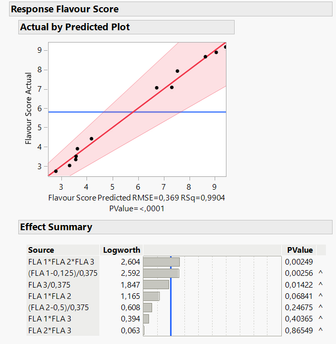

2. DOE three mixture components + one process effect
JMP 17 results
JMP 18 results
In JMP 18 analysis above the model is different!
What has changed and why? Remark: despite of different plots & model graphs of JMP 17 - 18 prediction profilers are identical.

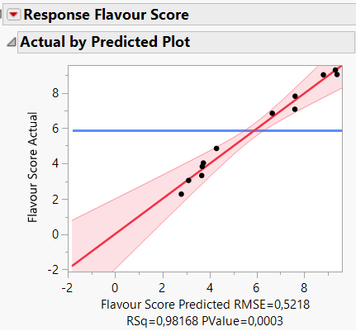

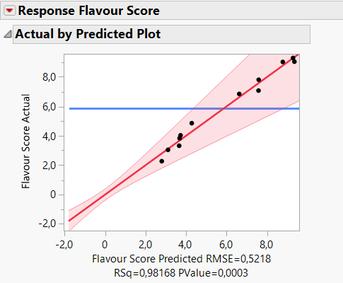

I might have found a clue about the difference in plots.
  • In JMP 17, when you extend the ranges of "Actual by Predicted" plot, it seems the plot is constructed by using a response mean of 0 (confidence band is symetrical around 0):
    So maybe the modeling without intercept of mixture models was (incorrectly ?) translated into a modeling with intercept = 0, hence the confidence band being large and non-symetrical around the response mean.
  • In JMP 18, you don't observe this situation as confidence band are symetrical around the response mean (5,88) :
Curious to know if any developers might confirm or inform about this difference in plots. @Ryan_Lekivetz ?

statman
Re: Different mixture experiment analysis results JMP 17 & 18
Strange, I used your data table and analyzed in both 17 and 18.  The only difference I found was the confidence limits on the Actual by Predicted  plots (leverage).  All of the other statistics were identical (I used your scripted fit model).
JMP18
JMP17
