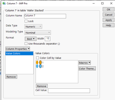

Maybe you can use Value Colors column property on Site column?
Or do you wish to have same color for all sites? If that is the case you can create new column with just single value and use that as Color instead of Site column

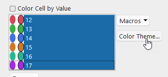

If you want to assign different colors to different entries, you can use value colors (as suggested by @jthi ) and apply a color theme:
or select all entries in the legend and assign a theme via the right click menu:
