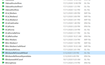

Hi Guys,
I recently had someone work on my computer, previously all the different JMP files, such as Scripts, Journals and Data tables had different icons when they were sitting in my working folder, since the work was done all these have the same icon and are very hard to identify unless i look at the extension, and everytime l click on one it reopens JMP,  so i may reopen JMP several times in one session, please see the attached photo. Does anyone have a work around??

It sounds crazy but reinstalling JMP might be the easiest solution to get the icons back, or you could set windows explorer to always show file extensions. A web search for 'windows 10 change icon for file type'  gives you details to fix icons without reinstalling JMP (looks like a pain), or a search for 'windows 10 always show file extensions' should show file extensions, which I prefer anyway.

I just had this happen to me on my Window 10 computer.  After following @ih advice to google "windows 10 change icon for file type" I ran across the video I've copied below.  I successfully restored my .jsl and .jrn icons using this approach.  But, you have to be willing to edit the registry.  It's up to you whether you are comfortable doing that or not.  Be careful if you do that....not recommending this approach, but rather making it available if you wish to take that risk.

Try going to
File=>Preferences=>Window's Specific
And then clicking on the Reset Associations button close to the bottom of the window
Jim

Thanks Jim,
No luck with that suggestions
