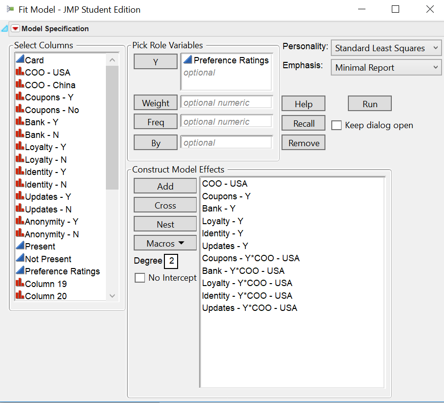

Hi all,
Newbie question here: I'm doing dummy variable regression using JMP for a school project. When I cross-referenced to Excel's version, I realized the coefficients are completely different even though the t-stats are the same.
JMP:
JMP version-Model.PNGJMP version-Model.PNGJMP-version-Model2.PNGJMP-version-Model2.PNG
These two images are of JMP and as you can see as compared to the Excel's version, the figures are different even though I'm using the same attributes.
And it's not because of the interaction effect as I did with just the variables, without the interaction effect (e.g. COO x Coupons) and the results are still different.
Strangely, Excel's version seems more correct than the JMP's version, aligning more closely with my secondary and other primary research.
Any advice?
