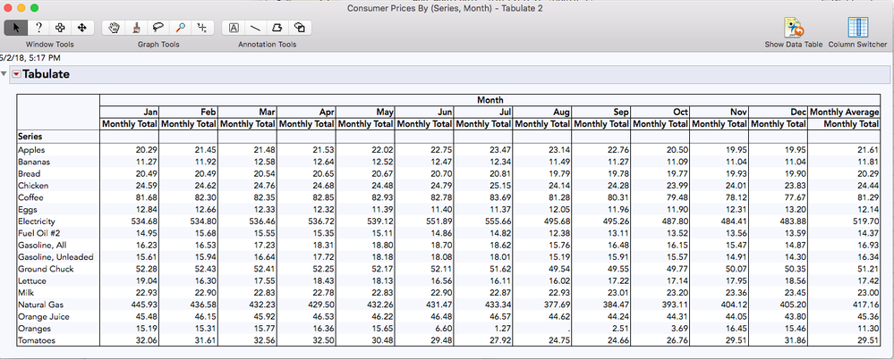

Hi @MariaK,
One way to do what you want is to create a summary table and then run tabulate on the summary table.
dt = Open( "$SAMPLE_DATA\Consumer Prices.jmp" );
dt << Summary(
	Group( :Series, :Month ),
	Sum( :Price ),
	Freq( "None" ),
	Weight( "None" )
dt2 = Current Data Table();
dt2:Name("Sum(Price)")<<Set Name("Monthly Total");
dt2 << Tabulate(
	Change Item Label(
		Statistics( Mean, " " ),
		Grouping Columns( :Month( "All" ), "Monthly Average" )
	Show Control Panel( 0 ),
	Set Format( Mean( :Monthly Total( 12, 2 ) ) ),
	Add Table(
		Column Table(
			Grouping Columns( :Month ),
			Add Aggregate Statistics( :Month ),
			Analysis Columns( :Monthly Total ),
			Statistics( Mean )
		Row Table( Grouping Columns( :Series ) )
Monthly AveragesMonthly Averagescheers,
Stan

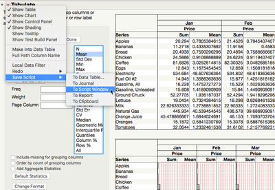

You're adding Mean as a Column Table in your script with the statement:
Column Table( Statistics( Mean ), Analysis Columns( :Price ) )
Instead you want to add it as an analysis column in the existing column table.
dt << Tabulate(
	Show Chart( 1 ),
	Add Table(
		Column Table(
			Analysis Columns( :Price ),
			Statistics( Sum, Mean )
To get this syntax I built the table interactive and then asked JMP for the script from the red triangle hotspot.

MariaK
Level I
Re: Tabulate - Add Monthly Average?
Thank you Stan!  Worked like a charm. :)
