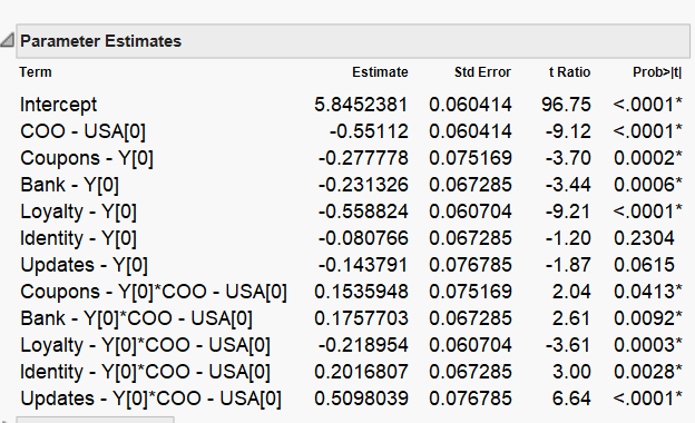

Newbie question here: I'm doing dummy variable regression using JMP for a school project. When I cross-referenced to Excel's version, I realized the coefficients are completely different even though the t-stats are the same.

These two images are of JMP and as you can see as compared to the Excel's version, the figures are different even though I'm using the same attributes.

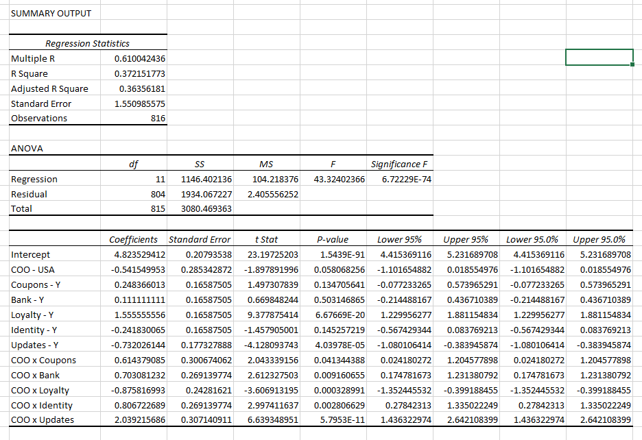

And it's not because of the interaction effect as I did with just the variables, without the interaction effect (e.g. COO x Coupons) and the results are still different.
Strangely, Excel's version seems more correct than the JMP's version, aligning more closely with my secondary and other primary research.

Excel is not more correct. They are just different. It has to do with the parameterization of the linear model. The choice is mathematically arbitrary but each way has its advantages. JMP uses effect parameterization. That way is supposed to make the parameter estimates more interpretable. They sum to zero, so the intercept is the mean response at the origin. The parameter for a given level is the change from the intercept. So an estimate of -0.55112 for COO - USA = 0 means that the mean for that level is 5.8482381 - 0.55112 = 5.2941181. The plots are meant to help interpret the selected model.
Since you are using numeric values with the correct nominal modeling type, JMP is correctly estimating the effect of these categorical predictors. The numeric code, though, might be interpreted by Excel as a continuous variable, since it has nothing like modeling type that is fundamental to statistical modeling and testing. That model could lead to a very different estimate, test, and interpretation.

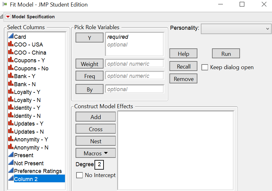

Adding to the newbie question (pardon me), I'm also looking at the interaction between the different variables with the country of origin.
From a software's perspective, is this how we set up the model (Use the 'Cross' Button) to study interaction effect between Updates and COO - USA?
Thanks in advance, Mark.

Correct, select the data columns for the factors involved in the interaction and click Cross.
See the Macros button for many convenient shortcuts, such as Factorial to Degree. With degree set to 2, it will add all possible two-factors using the selected data columns.

Yes you're right. A respondent contributes more than one observation, but the analysis interprets each observation as independent and as one respondent when the actual case it's not true.
What I want to do is to adjust for standard errors for such clustered correlation, in JMP's Fit Model.
How can do I from the console below (if it's from here)? (:

Re: Difference between JMP and Excel in dummy variable regression outputs
First, as I said before, you don't need to create dummy variables in JMP. It is a statistical analysis and modeling software.
Second, create data columns as I described for the factors (not separate dummy variable columns for each factor level) so that each factor uses one data column and enter the value directly for each row.
Third, create a column (Respondent, for example) and populate it with values that identify the respondent for each row.
Now select Analyze > Fit Model. Select the response column and click Y. Select the factor columns and click Add or use Cross or a macro to add interaction effects to your model. Select the Respondent effect (not the data column), click the red triangle next to Attributes and select Random Effect. That change is all you have to do. You are simply distinguishing the type of effect of Respondent (random) from that of the other factors (fixed).
