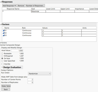

See the screenshot with the several options in JMP (DoE, Classical, Response Surface platform) with coded factors values with -1 and +1:
Only the "Inscribe" checkbox option or "On Face" design option will create star points with values equal or less extreme than the boundary values of your factors (-1/+1).
If you want to prevent negative values in runs, you should avoid circumscribed CCD, and aim for face-centered or inscribed CCD types. On a similar topic, I showed that the farthest the star points are from the centre of the experimental space :
