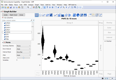

No values on y axis?
I am following the usual procedure of dropping the columns on x axis but JMP is not showing any values on the y axis.  I have values on the graph & arrows upwards?

I answered you once in How do I get values on y axis? .
JMP is using Parallel Merged "axis" as there is too much difference between the ranges of your columns. You can change it to Parallel Independent and try to see how it would look like. To change it right click on x-axis -> Combine Scales -> Choose which works best for you.

jthi
Re: No values on y axis?

lisaash
Level II
It works - thanks
