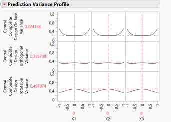

Here is a short Power comparison for the three design types of star points locations: On face (-1/1), Orthogonal (-1,29/1,29) and Rotatable (-1,68/1,68) :
And variance comparison :
As you can see, the farthest the star points are from the centre of the experimental space :
  • The higher the power for main effects and quadratic effects, but the lower the power for the intercept,
  • The higher the variance in the centre of the experimental space, but the lower the variances at the border of the experimental space.

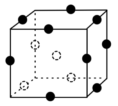

Box Behnken designs are very different from Central Composite Designs or Response Surface Custom/optimal designs.
This classical design is used in litterature as one of the design having the "best precision", as more power is available for quadratic power, and also because this design has uniform precision in the experimental space, often for a lower number of runs than for the Central Composite Design. It should be centered in the optimal experimental space, or very close from it. More infos on Box-Benhken : The Open Educator - 4. Box-Behnken Response Surface Methodology
Because of these characteristics and differences, the repartition of points is different (different combinations of factors as you mention):

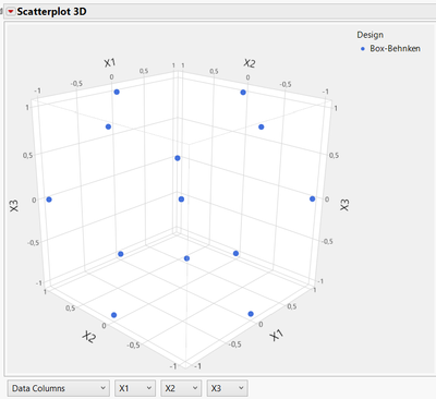

Box-Behnken (15 runs by default for 3 factors in JMP, no points in the corners) :

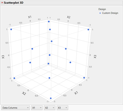

Optimal RSM design (Custom design, 16 runs by default for 3 factors) :

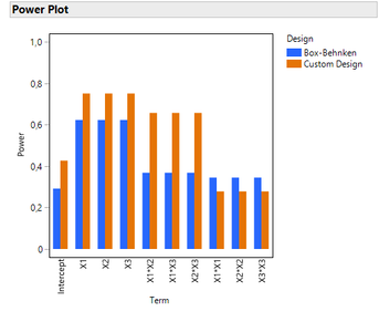

And here is the comparison for power (detection of effects) :
Optimal RSM design has higher power for main effects, 2-factors interactions. Box-Behnken has slightly higher power for quadratic effects.

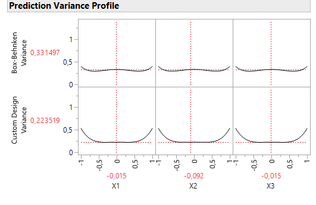

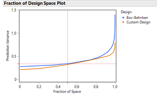

Concerning the prediction variance profile, the Custom Design does a slightly better job than the Box-Behnken.

statman
Re: why are no star points in custom design RSM
To be clear, the primary reason the Box-Behnken design was "invented" was because the extreme vertices (corners of the space or star points) were not possible combinations of levels to run (essentially a constraint).  Again, it is important to visualize the space you are experimenting in.
