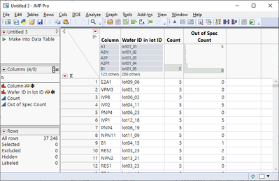

@jthi yes, I did try Grouping by  "Wafer ID in lot ID",  which gives me a table with the required data, but I have not been able to extract the parameter yield I want from it. I am thinking of using the Summarize function but am not yet sure how to use it. Any help would be very useful.

I'm not sure what you wish to use the Summarize for? You can very easily get a table like this from Process Screening and then you just add one formula and you should get what you need (or maybe I'm missing something)

As this has been marked solved, I will also provide at least some sort of a final solution
Names Default To Here(1);
dt = Open("$SAMPLE_DATA/Semiconductor Capability.jmp");
ps = dt << Process Screening(
	Process Variables(Column Group("Processes")),
	Grouping(:Wafer ID in lot ID),
	Control Chart Type("Indiv and MR"),
	Within Sigma(0),
	Overall Sigma(0),
	Stability Index(0),
	Mean(0),
	Show Tests(0),
	Test 1(0),
	Out of Spec Rate(0),
	Latest Out of Spec(0),
	Cpk(0),
	Ppk(0)
dt_result = Report(ps)[Outline Box("Process Screening"), Table Box(1)] << Make Into Data Table;
ps << close window;
wait(0);
new_col = dt_result << New Column("Yield", Numeric, Continuous, Format("Percent", 12, 3), Formula(
	(:Count - :"Out of Spec Count"n) / :Count)
dt_result << run formulas;
new_col << delete formula;
-Jarmo
