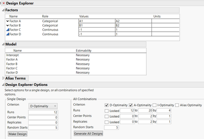

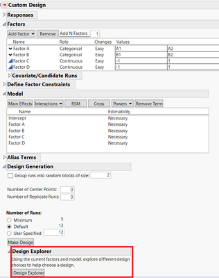

  • When creating designs, it's best to build several designs with different methodologies (for example in your case, build a classical screening/factorial design, a D-Optimal and other relevant screening design strategies) and different runs size, and compare the performances and characteristics of your design using the Compare Designs platform. This will give you more information about the relative performances of each design, and their limitations regarding the aliasing structure, power to detect active effects, and relative prediction variance profile).
  • When using the Custom Designs platform with the factors type you have, you can automate the creation of several designs in terms of runs size, optimality criterion, etc... by using the Design Explorer :
    There are a lot of options you can try to build several designs according to a model, and compare the relative performances of the design easily thanks to an enhanced table with all informations :

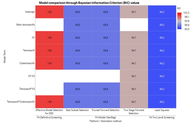

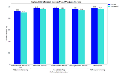

  • There is no "best" estimation methods in Generalized Regression, as it will be dependant on your objective, design characteristics, and data available. I would recommend trying several estimation methods, and compare their performances as well as the terms included in the models estimated by each method, to see how well these methods agree :
    Example with R²/R²adjusted :
    Example of terms agreement between each estimation method :
    (Visuals from my presentation in the french User group : Découverte des plans OML (Orthogonal Main Effects Screening Designs for Mixed Level Factors) pour le...
    I would recommend trying other Estimation Method Options like Pruned Forward Selection and Best Subset Selection (only for low number of factors and acceptable number of terms in the model !) with the "Enforce Effect Heredity" option checked from Advanced Controls. Another great option for screening design is to use The Fit Two Level Screening Platform that can help build relevant models if the assumptions behind the use of this platform are met : Overview of the Fit Two Level Screening Platform
    Which criterion/criteria you use to evaluate and compare models depends on your objective.

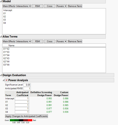

  • By default, when evaluating or comparing a Definitive Screening Design, the model effect will be only comprised of main effects. You can add some interaction or quadratic effects terms, in the limit of your degrees of freedom available (related to the number of independent runs in your design). A DSD is not able to fit a full response surface model (with all main effects, quadratic effects and interaction terms), other designs such as Central Composite Designs or Box-Behnken are more appropriate to fit this complete model. As DSD is typically used in a screening stage, it relies on effects sparsity, hierarchy and heredity principles to identify the few important active terms from the many negligible, and thanks to it's good projection properties, may be able to fit a full response surface model if the active terms are not too many.
  • A-optimality criterion helps minimize the average variance of the parameter estimates of your assumed model. This criterion helps minimize correlations between your terms (that would otherwise inflate parameters estimates variance), which also helps model selection, as it becomes much easier to determine which effects are statistically significant. Moreover, you can also adjust weights for estimating more precisely certain effects (for example putting more emphasis on main effects vs. interaction effects) with A-Optimal designs using the option A- Optimality Parameter Weights.
    Bradley Jones gave an excellent talk on this topic : 21st Century Screening Designs (2020-US-45MP-538)
    Jonathan Stallrich also compared in 2022 the properties of D- and A-Optimal designs regarding the minimization of estimation variance and bias, and found that A-Optimality criterion offer less candidate designs with similar or better properties than D-Optimality. The paper is available here : https://arxiv.org/abs/2210.13943
For these reasons, A-Optimality is the recommended optimality criterion used by JMP when using two-level designs for main effects and two-factor interactions.
