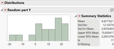

When I look at the "noise"/variability part of your response formula, I can see that the random uniform part is quite large (from -25 to 25) compared to the size of the estimates (from -20,8 to 5,2) for the factors you want to detect in this first stage. So for most factors for which you have specified an effect size to estimate, it might be very hard to detect them and estimate their effect size, compared to the noise/variability part that you have added in the formula. You also mention 5 "active" factors, but I think there is a confusion : they will be only considered "active" only if their relative size of estimates are large enough compared to noise/natural variability of your experiments. It is not because you have specified an estimate different from 0 that they should be considered as active/important. It's a question of signal-to-noise ratio, and a difference between statistical significance and practical significance.

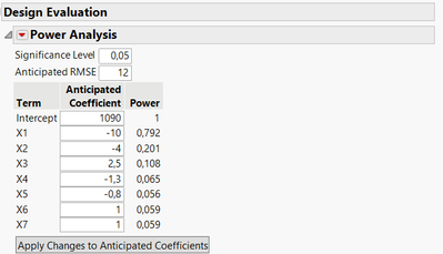

The significance level (p-value threshold) to adjust could be estimated depending on your design and assumed noise (anticipated RMSE) in the Evaluate Designs platform. In this platform, you can adjust significance level and Anticipated RMSE to evaluate the power (probability to detect an effect if active).
Perhaps not "exactly rigorous", but as an exercice, you can check if the outputs from your analysis seem right as you're working on a theoritical response formula. When adding a new formula column to look at the noise part of the formula, I can estimate a standard deviation of approximately 12 :
When using this value as Anticipated RMSE (probably as a low estimate for RMSE), fixing the significance level at 0.05 and using the theoritical estimates of the formula as Anticipated coefficients (I left "1" for the null effects of your formula to see the power "baseline" of your design for main effects with this RMSE), it matches the outputs from your analysis :
Only X1 has an effect size large enough to be detected with a high probability. The other effects have a relatively too low effect size (compared to the Anticipated RMSE of the response). If you have a higher significance threshold with the same expected noise, the power to detect main effects will increase :

  1. You can reduce the variability (random uniform part in the Y formula response), to make sure you can detect most of the active effects you want to detect (and estimate).

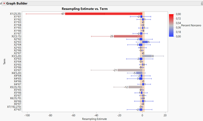

Also SVEM forward selection does a good job! cfr. attachment

I have mixed feelings on the output and (systematic) use of SVEM, particularly on noisy data.
SVEM forward selection does not "select" terms in the model (or filter them thanks to a specific statistical criterion and threshold), but instead try to estimate them as precisely as possible thanks to the data points resampling with various training/validation anticorrelated weights. By default, every terms will be considered and estimated with SVEM.
So if your objective is about understanding and filtering the main important effects through screening, SVEM might not help you further, as you're lacking a decision framework (statistical criterion, metric and threshold) to do this. SVEM is however very helpful in a predictive mindset, for precise terms estimation.
However :
  • You could use the column/metric "Percent NonZero" as a statistical metric to refine the model, but you'll have the same difficulty as with p-values to define a threshold : should a term be >50% non-zero to be included in the model and considered "active" ? Or another level ?
  • By visualizing the data from SVEM model, you can probably highlight some key effects and select them based on practical importance (for example, absolute value of the term should be > 2) : Victor_G_0-1738944726348.png
    But again, the definition of this "acceptance" threshold may involve a lot of domain expertise and thinking to not exclude prematurely some terms that could be interesting to investigate further.

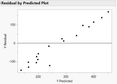

Also if you look at the residuals pattern, something strange happen :
I would not trust a regression model that shows this non-random residuals pattern (bias). But this can be "improved" by lowering the model complexity, if you launch SVEM GenReg only with main effects :
It seems there might be a curvature in the residual pattern. So obviously in your example, interactions and quadratic effects of your response formula are not investigated here in this simple model, and that can explain this curvature pattern.
I don't think complexifying model building and estimation is the thing to do, particularly with noisy data like in this example.
