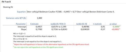

I would like to compare two measurement methods using a deming regression.
This is a follow-up study, and in the first study my colleagues have used a deming regression in the "Analyze it" platform in Excel. But we don't have access to the software anymore, so instead I would like to conduct the analysis using JMP v. 16.

The Deming analysis output in "Analyze it" contains the slope, intercept, and CI and p-value for the slope and intercept. Moreover the CI values are Jackknife 95%.

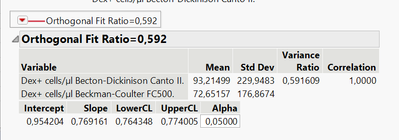

The output from Orthogonal fit in JMP only contains slope, intercept and confidence interval for the slope.
So, my question is how can I interpret the JMP output and determine if the two measurement methods are different without having the CI for the intercept and p-values for the slope and intercept. Do I need additional analyses, like Bland Altman in addition to the Orthogonal fit?

Yes, the orthogonal regression in the Bivariate platform is Deming regression. Alpha is set to 0.05 so the lower and upper limits are 95% confidence. The slope interval does not contain 1, so you decide that the two measurements are not equal.
Select Analyze > Specialized Modeling > Matched Pairs to see a Bland Altman analysis. That could answer the questions about the intercept not equal to zero, but you will find based on the result for the slope that it is not a constant bias, but a proportional bias.
