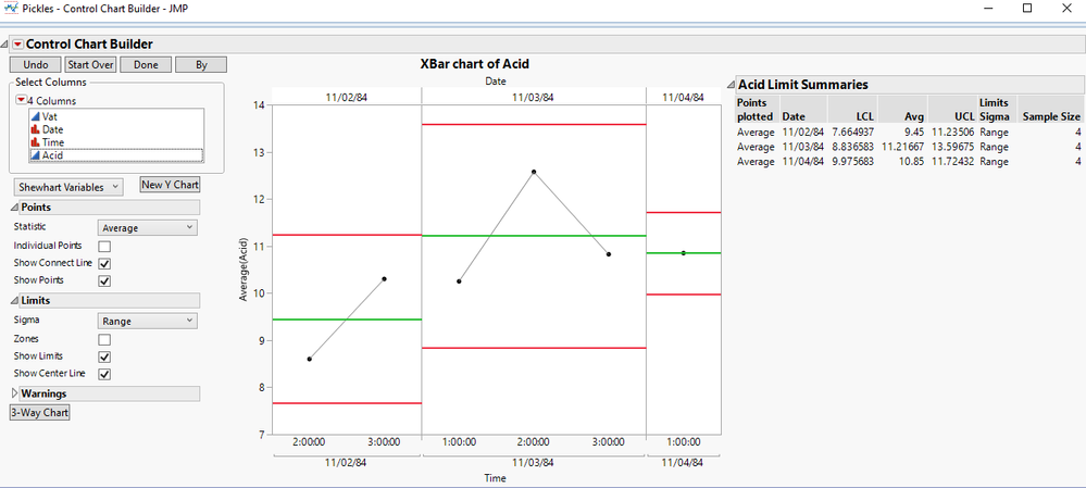

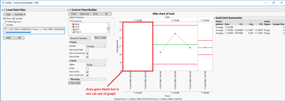

I am preparing a control chart, but I dont want to show data on 11/02/84 on the chart below. Normally, with graph builder, I will just use a local data filter to filter out the dates I do not want.
However, with control chart builder, there is a space left where the data has been filtered (see below.) Is there a way to make control chart builder behave like graph builder when using a local data filter? Graph builder will re-fit the X-axis to match the specified data range.

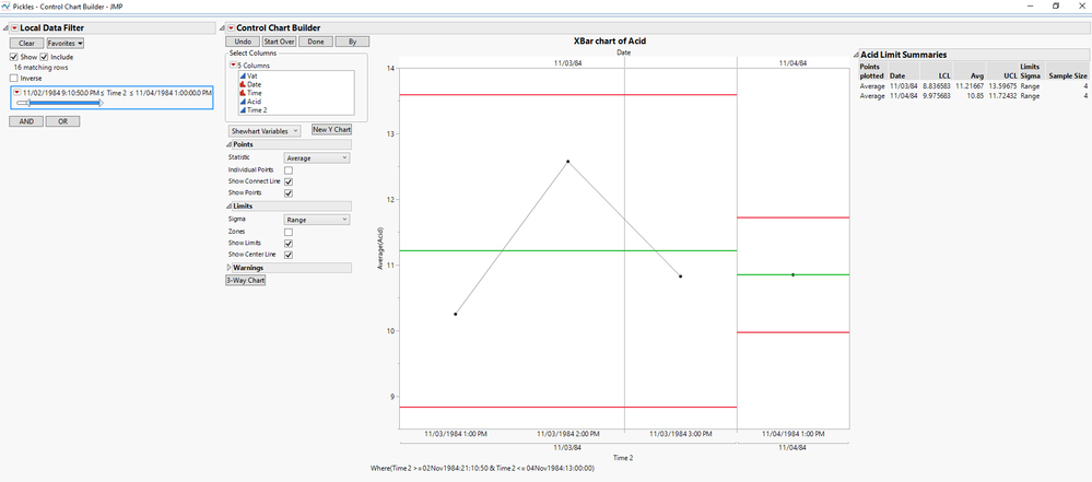

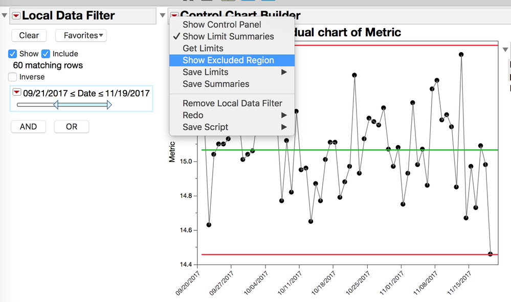

Try rurning off the "Show Excluded Region" option

The problem of incorrect phase divider lines with show excluded region turned off was fixed in JMP 14.1.  You need to upgrade.

Thanks for the tip! However, for some reason an unnecessary grey vertical line goes onto the graph once I turn off the "Show Excluded Region" option. Do you know what might be happening?

Thanks for the tip! Upgrading to JMP 14.1 fixed the problem right away.
