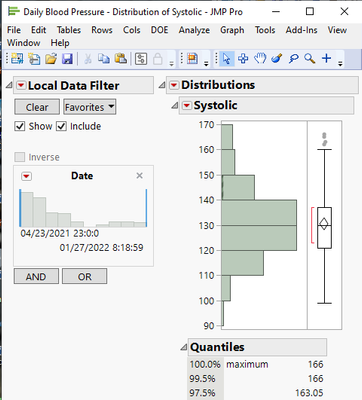

I have a column with a Date and Time in it (see graphic for formatting).  When I use a Global or Local Data Filter, the dates/times show up as MM/DD/YY H:M:S.0 with the ".0" being extraneous (see graphic for data filter).
Does anyone know how to get rid of the ".0" in the data filter?

If you set the following Custom Format for you date column, the Local Data Filter will drop the .0
Char( Format( :value, "m/d/y" ) ) || " " || Char( Hour( :value ) ) || ":" || Char( Minute( :value ) ) || ":" || Char( Round( Second( :value ) ) );

 Thanks @txnelson, I will try that. But it appears you are saying I need a new "second" date column for this to work - is that correct?  I guess another way to approach this is to use a For Each Row and replace the data that is there with this new value.

You do not need a new column.  Second() is just a function that extracts the number of seconds value from the Date/Time column
Attached is the example data table I used for my last response
