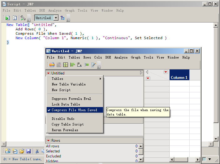

I made a file with the GUI, set the column to numeric(1) and used the red triangle to request compression on disk. Then I grabbed the script.
New Table( "Untitled",
    Add Rows( 0 ),
    Compress File When Saved( 1 ),
    New Column( "Column 1", Numeric( 1 ), "Continuous", Set Selected )

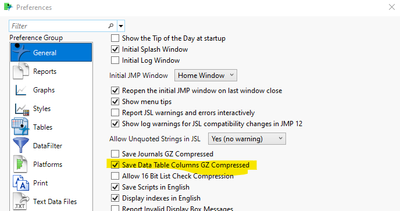

Hello,
You can set this preference and after by default all tables will be compressed.
or by scripting as mentioned by @Craige_Hales
Compress File When Saved( 1 );
    Add Rows( 0 ),

Hello,
