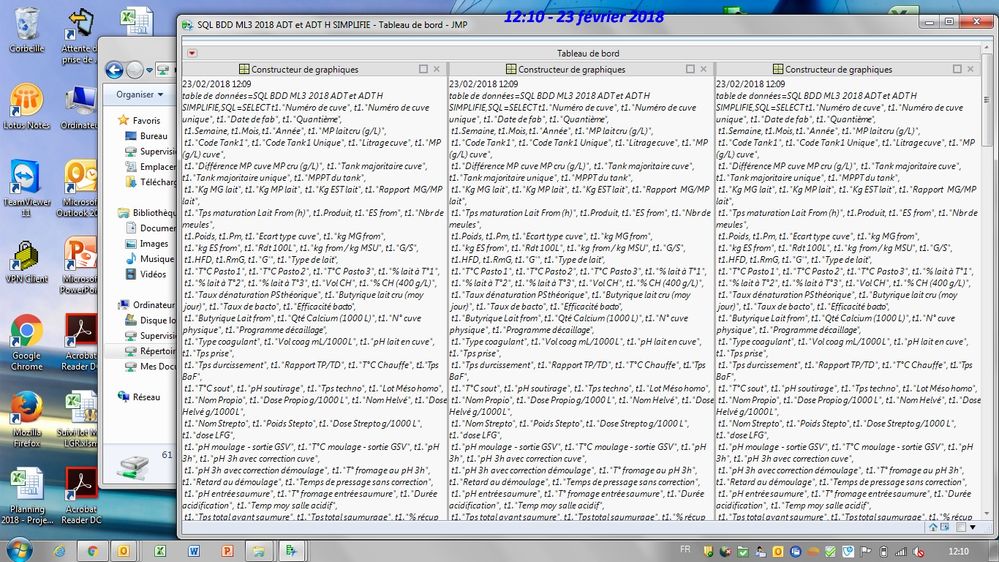

Hello
I've an another question:
I've sent to a collegue who has JMP a script to build a dashboard.
on my computer, all was Ok: I can see the graphs.
but on his computer, he can't see it; See his screen.he has access to all files for the dashboard.
Why can't he see the graphs?
Sans titre 3.jpgSans titre 3.jpgbut he can't:
Re: Dashboard window
It looks like your colleague has turned on the Report preferences for "Date Title on Output" and "Data Table Title on Output".  The latter option in this case is showing not only the data table name but also the additional text including the full SQL for the source of the table.  We will look into this further to see what improvements can be made, but I think the solution for now would be to turn this option off in Preferences.  I think the graphs are being stretched down to a size of 0 or possibly clipped, because the text is very large and is not stretchable.
hello,
you are right.
For my computer,if  I have only the option "Data Table Title on Output" turned on, I have the same sreen than my colleague: only the text, not the graphs.
Thanks!
