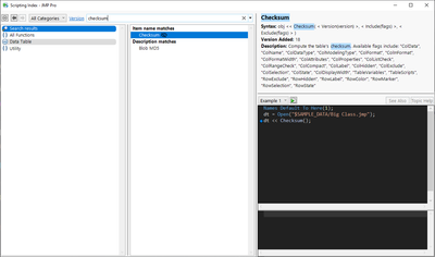

For JMP tables there is also "internal" << Checksum() message
I have tested of using this on my "Preview data table" class and it seemed to work fine. Not sure how robust it will be due to the "internal use only".

thanks @jthi , that data table message is new in v18, it appears, and it would work for JMP data tables.  My need is more general purpose, that would work for any type of file (.JMP, .JMPADDIN, .JMPXXXXX, .DOCX, .XLSX, .TXT, ...)
