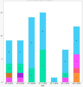

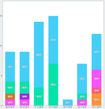

I created dashboard of many graphs and save as interactive HTML, using JMP 14.1.0
Graph in JMP looks ok but graph in Interactive HTML shows 3 decimal and I don't want this. I tried to search how to set for interactive HTML but couldn't it. Please advise.

The behavior you explained could be replicated after your submission to Techincal Support. We will be reporting the behavior to Development to be addressed in a future release of JMP.

It looks like this issue was successfully fixed in JMP 15 and later versions.

What Summary Statistic is selected in Graph Builder?  For certain statistics we attempt to provide extra precision.

@josh_markwordt I used Summary Statistic 'N'.

If this uses Summary Statistic( "N" ), it would be worth trying in JMP 14.2.
I fixed a similar bug, though I'm not sure this is the same case.
