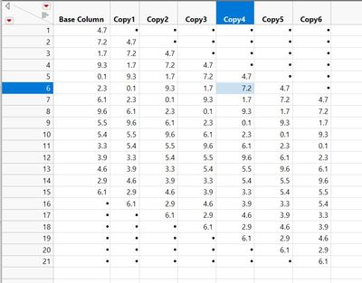

Hi JMP Community, I am looking for a solution to facilate copying, in one go, a column a number times (in the example below I have chosen 6 times), but all data should move one row down with every new copied column that is created? Thank you for your help!

You already have two good solutions (and one marked as the solution), but there is another quick interactive way to do this too, that people sometimes forget. Select the original column and right-click on the column header choosing New Column Formula > Row > Lag Multiple. In the dialog put in the First Lag as 1 and the Last Lag as 6.

Re: How do I copy a column multiple times while shifting each time one row down?
Dan Obermiller
WernerL
Level III
Many thanks Dan, this is an incredibly straightforward and simple solution. I am sure there are many more hidden such hidden treasures in JMP!
