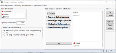

     Analyze=>Quality and Process=>Process Capability
Fill in the Y, Process variable and place the column that has your week value into the "By" selection area

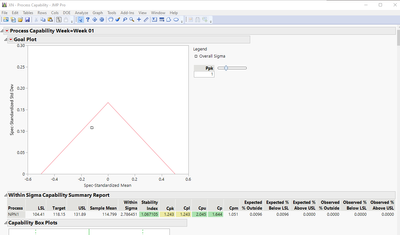

In the output report window, hold down the CNTL key, and then click on the red triangle for the Process Capability, and select
     Summary Reports=>Within Sigma Summary Report
Holding down the CNTL key will signal JMP to create the report for all of the Weeks.

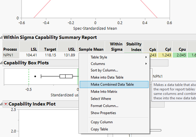

Right click on the summary report, and select

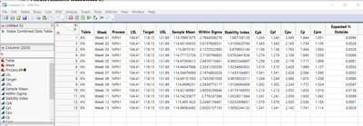

     Create Combined Data Table
This will create a new data table that has all of the Cp/Cpk information for each week, which you can then use as your report
