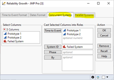

Reliability Growth supports multiple systems in a couple of ways. If you have a fairly recent JMP, you should see two tabs in the launch dialog for the situation:
Based on your description (integrating improvements across systems), the Concurrent Systems is designed for your case, but with a special input data format, and you can find a sample in the sample data folder. And if you data look like this, you should use this tab.

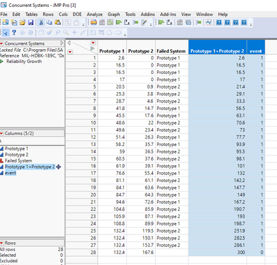

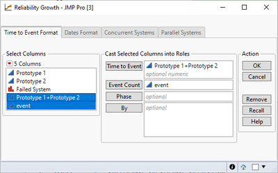

Otherwise, you may need to "assemble" your combined single system, and analyze that assembled data. I cannot be sure how to "assemble" your multiple systems into a combined one. It all depends on your input data format. But the main idea is get cumulative time at every event. For example, following is the screenshot of the "Concurrent Systems.jmp" data table. The first three columns are in the original data table, I added the last two to illustrate what a combined system looks like. Let me explain what happens here.
The original data table stores the testing process of two systems. Every row records an event, either on Prototype 1 or 2. And at the occurrence of the event, the first column records cumulative run time on Prototype1, and the second records cumulative run time on Prototype2. Then I simply add those two values and create column 4, which is the total run time of both systems, and mark 1 event for that row in column 5. I do it all the way, until the last row, for which is the end of experiment for both systems and not an event. So I calculate the total run time, put in column 4, and record event count 0 for that row in column 5.
Now use the 4th and 5th column as the data from a single system and analyze it. That is all what the Concurrent Systems does under the hood.
