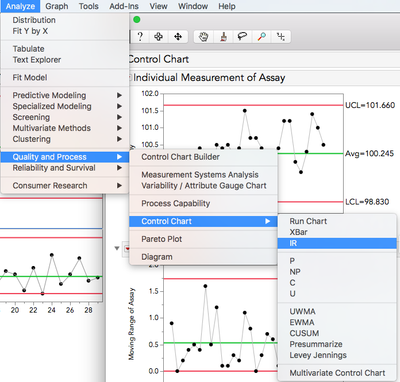

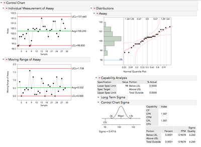

If I assume that you are dealing with a one sided specification of >98% Assay for instance I can use either Quality and Process Control Chart Builder or an IR/MR control chart under the Analyze>Quality and Process platform.

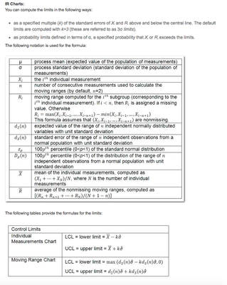

For Within sigma JMP is using which Constant?
d2=? 1.1.28 or any other?

But My Question is For Within sigma JMP is using which Constant?

If I may add a point here:  If I assume your data is in time order (a requirement for a control chart), then you definitively have two populations in your data.  The first 9 data points comprise one population and the remaining 20 points comprise the second.  You can calculate Capability Indices for both populations separately, but to calculate a Capability for the entire data set is meaningless.  Any process must be in a "reasonable degree of statistical control" before one can calculate meaningful Capability Indices.  Your first question from this data set should be, "What happened to the process between somewhere around data points 9 and 10 that caused the process to shift upwards."  If the special cause of the shift is a good thing, you need to understand what the cause is and modify the system to make this permanent.

For individuals/moving range charts, you should always use the following formulas for computing limits:
Limits for Individuals chart = average ± 2.66 * average moving range
Upper limit for mR chart = 3.268 * average moving range
As Dr. Wheeler says in his articles on the right and wrong ways to do control charts, "Accept no other limits".
