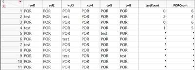

I have a script with col 1-6 in a list
I am trying to write a JSL script that will count how many times the word POR appear, and how many times the word test appears
example below (did it manually the last 2 columns)
reading the forum I understand I need to convert DT into a matrix, but I am not able to make it work.
thanks!

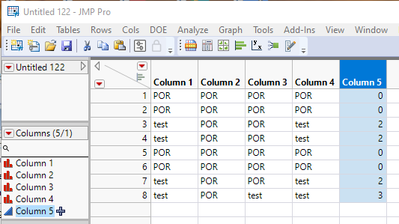

I created in JMP the table as you provided
I then created a new column and applied the following formula to that column
count = 0;
For( i = 1, i <= 4, i++,
	count = Sum( count, Contains( As Column( i ), "test" ) )
count;
Please note, the For() loop only goes up to 4, because there are only 4 columns in the table to process
It gives the following results
I have attached the data table

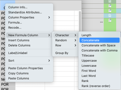

Yet another way involves concatenating all the columns with a 1-click transform.
Since "test" is 1 character more than POR, and you've no missing data, the resultant string will increase by 1 character for every "test" contained, compared to a sting of only "POR"s.
To concatenate, select the columns of interest and right-click, selecting as below. Then rename the column "concat" for brevity.
In the example table below, there are 6 columns of interest; a string with only "POR"s would thus have 6 * 3 = 18 characters.
Hence, we use the formulas:
length(:concat) - 18 for the number of "test" == n_test.
and
6 - n_test for the number of "POR".
In general, for n_test we'd use (length(:concat) - 18)/k, where k is the difference in characters between the 2 phrases. Here, since k == 1, we omit it.
