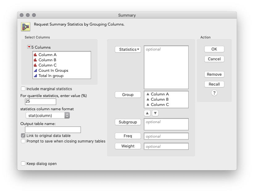

Alternatively, if you wish to create a table that lists unique rows only once, with the number of times they matched, you can use Tables > Summary. Enter in your columns as Group, and hit okay. Here's what that setup looks like:

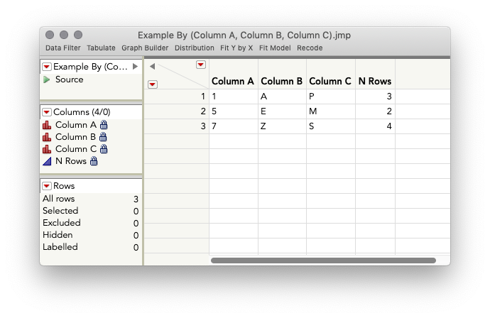

This will return a summary table that shows the unique combinations of values in those three columns, along with a column showing the number of occurrences in the data table. Screen Shot 2019-06-20 at 1.42.23 PM.png

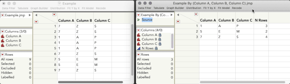

Once you have this table, you can select, and then drag the N Rows column from the summary table directly into your original table, and JMP will handle all the Matching for you to update the original table with those values. Here's what that looks like:drag.gif
Finally, the script for making the table is also saved as a Source script to the summary table:

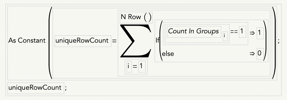

I believe I understand what you're asking, but let me reiterate back to make sure. You'd like a new column that has a count of the number of unique combinations, regardless of how many times those combinations occurred? In the subset you provided, there are 3 unique combinations of the three columns, and as you pointed out, one of the combinations occurred 4 times, another 3 times, and another 2 times. Another way to say this is how many unique rows do you have, as defined by the first three columns. If this is indeed what you're after, the following column formula will do, which essentially counts up the number of times a 1 occurs in the "Count In Groups" Columns, i.e., the number of unique groups:
As Constant(
	uniqueRowCount = Summation(
		i = 1,
		N Row(),
		If( :Count In Groups[i] == 1,
			1,
			0
uniqueRowCount;
I've attached the new table here as well. Is this what you were looking to do?
