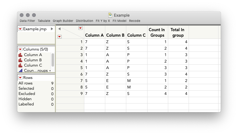

There are a few ways you could go about this. I think a formula column approach is relatively straightforward, with two columns, first, one that counts the occurrences of a match incrementally, and then a second column that finds the max value of that count by group, which is what you're calling a counted tally here. Here's what that table looks like:Screen Shot 2019-06-20 at 1.34.14 PM.png

Col Cumulative Sum( 1, :Column A, :Column B, :Column C )
and the Max of that count column, also grouped by the columns used for a match
Col Maximum( :Count In Groups, :Column A, :Column B, :Column C )

Hi @Sciguy_1

Counting in groups by the columns used for a match:
