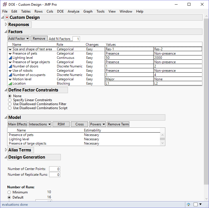

If I chose to use Method 3: RCBD as you mentioned to replicate the treatments over 2 blocks (best and worst locations), it is like the following:

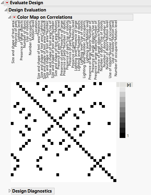

The default number of runs is 16, and then the "Color Map on Correlations" is as follows:
From the above color map, it seems the model is not the main effect model.  In general terms, the color map for a good design shows a lot of white off the diagonal, indicating orthogonality or small correlations between distinct terms. Does this mean that this is not a good design? And if I increase the number of runs, it will show most of white off the diagonal, whether it means I need to increase the number of runs when I do experimental design?

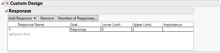

Our response is a binary value (0/1), 0 indicates non-presence of occupants, 1 indicates presence of occupants, for the response, I used "Maximum" as the Goal, as follows:
Is this proper, or should I use "None" as the Goal?

While both @P_Bartell and I are trying to give you some advice, you should realize there is no "right" design. Every design will potentially vary in in the resources required, the precision of detecting design factor effects, the resolution, the model that can be estimated, the number of factors that can be estimated, etc. What I recommend is to design multiple experiments and evaluate them against the set of criteria and your situation. I also suggest you predict all possible outcomes and what you will do in each outcome. You have 8 design factors and at least 1 noise variable. The purpose of this 1st experiment is to design a better experiment (move the design space and identify the factors that are most interesting). Usually a lower resolution will work to identify main effects, but you should rank order the model effects up to 2nd order to determine whether you need to bump the resolution. Also when you have JMP block the design, the software treats the block as a random effect by default. However, when you know what noise is making up the block, you can treat it as a fixed effect and quantify block-by-factor interactions. I'm a bit old school you might say. I want to know the aliasing and don't like to do partial aliasing as this is more difficult to interpret and determine what the subsequent experiment should be. But I am probably in the minority here. Many folks like the optimal designs for their efficiency. I also don't fill in any Y's as I don't want the software to "control" my analysis (in some cases, limit my analysis options).

The Location seems to be a categorical factor with fixed effects. Is it really a restriction on availability? That is, you can only make a limited number of observations per location? How many locations are at your disposal? The fact that you called the two locations "best" and "worst" suggests a qualitative or categorical factor to me.
The model by default is only the main or additive effects. The color map shows you higher order terms, too, so that you can assess the impact of these effects (correlation) on the main effects. The effects will bias your model if you do not include them and increase the standard errors of the estimates if they are included.
What is the response? Is it binary or is it a count of two binary outcomes? For example, I might observe 20 instances in each run and record the number of each outcome (succeed, fail). On the other hand, I might only observe 1 instance in each run. You cannot use the power analysis in custom design in the case of such a response. But you certainly need more runs for such a response. The Simulate Response command in Custom Design along with the Simulate feature in JMP Pro can be used to assess the empirical power of any design.
The goal for the response is saved as the Response Limits column property. It defines the desirability function for optimization in the prediction profiler. I do not think it is appropriate for this case, but you can change it after you get to the profiler, and then save the updated definition.

For the location, the background is we set up the occupancy sensors, people will stand in different locations in a testing space, and then we evaluate whether the occupancy sensor will detect occupants or not. Because we want to know whether people's location would impact the performance of the occupancy sensors. Initially, we chose 8 random locations as 8 levels for the location variable. But base on our discussion with @statman, it is better not to use 8 levels for the first experimental design, that's why we decided to choose the extreme cases for the location, one is the worst case where the sensor couldn't detect occupants, one is the best case where people just stand right before the sensor so the sensor will detect occupants perfectly. So maybe it is not a restriction on availability? It is just a variable we want to vary to see how it impacts the response?
For the response, it is a binary value that we observe 1 instance in each run. For our case, the response is the Presence/Non-presence of people. Presence means the sensor detects occupants, Non-presence means the sensor doesn't detect occupants. So in this case, what should I choose for the goal of the response?

I would treat the Location factor as a simple Categorical factor, not a blocking factor.
I would define the response in Custom Design to have no goal. It will be easier to define the desirability function later in the profiler.
A single trial (one yes or no result) means that you will need a lot of runs to estimate the logistic regression or the binomial GLM  model well.

On this point I disagree with @Mark_Bailey. Location in the room is noise and as such it should be treated as noise in experimentation. You don't want to conclude location is significant and the people have to stand here for it to work. You won't sell may of those sensors or the ones you do sell will have many customer complaints (It only works when I stand here).
