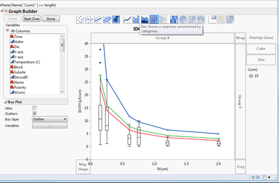

Sorry, I seem to not be explaining this properly. Below is the graph I have achieved from two different data tables containing different data sets:
I have done this through scripting. As you can see, the legend for the box plots is present but the legend for the line graph is missing as it is not copied when using the 'copy frame contents'. Am i being more clear?
