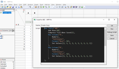

In that case, << Get Script should work for you
Names Default To Here(1);
dt = New Table("ABC",
	Add Rows(10),
	New Column("A", Set Each Value(1)),
	New Column("B", Set Each Value(1)),
tablescript = dt << get script;
Eval(EvalExpr(
	dt << New Script("Create Copy", Expr(NameExpr(tablescript)));
If you really really wish to use Copy Table Script() (not sure why you would in case like this) use Get Clipboard() with Parse()
	Add Rows(10),
Eval(EvalExpr(

shampton82
Level VII
Re: How to use Copy Table Script()
Nice!
I didn't realize that I could just use get script, I was trying to copy the red arrow action of copy table script so that was what I found in the scripting index.
