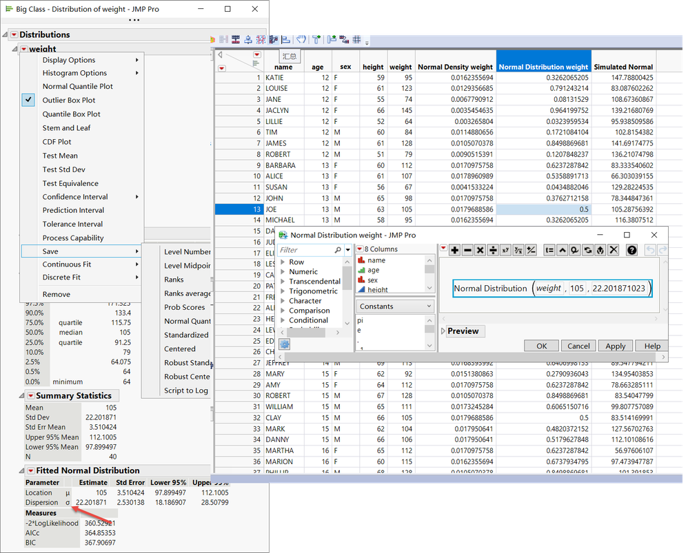

How to find the σ value of a normal distribution using JSL?
Thanks Experts!
NamesDefaultToHere(1);
obj = dt << Distribution(Column(:Weight));
obj << Fit Normal;
1 REPLY 1
txnelson
Re: How to find the σ value of a normal distribution using JSL?
Col Std Dev( :weight );
Jim
