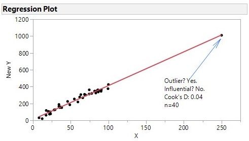

A general rule of thumb for cutoff on Cook's D is to use 4/n. If your data had 40 data points, for example, a Cook's D > 0.1 would be considered influential. Using 1 may not be the best choice.
And to echo one of Mark Bailey's comments: an outlier is not always influential.

Thank you all for response. An outlier is not always influential is what I wanted to know. Thank you Dan for the viz.this helps.
