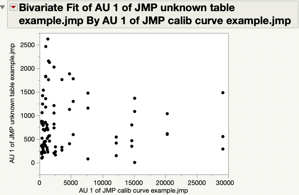

I have followed the steps you mention to get the custom inverse prediction. Yes, it is a linear regression.
My problem with that is the limited number of unknows I can enter. The scripting question was asked having in mind that I have thousands of unknowns and I assumed that scripting the procedure would allow me to values for all those unknowns.

Maybe it's a JMP version issue (I have JMP 13.1) but the script does not work. I used the JSL Debugger and I get an error right at the start: Name Unresolved: Get Data Table List in access or evaluation of 'Get Data Table List' , Get Data Table List() /*###*/

I am confused.
First of all, did it work or not? Did it work up to a point?
Second, yes, the calibration is performed entirely with the AU 1 and AU 2 values in the calibration table. Is that not correct?
Third, you don't have AU 2 values in the unknown table. Do you mean to use the predicted unknown AU 2 values?
Fourth, is this a change to the calibration definition or is it a new requirement (follow on step) after predicting the AU 2 in the unknown table?
Fifth, what is Sample? How does it relate to Peps?
Sixth, shouldn't the AU 1 in the calibrator table for Pep1 to Pep29 be correlated? They are not:
I am probably missing something very important and very basic.
