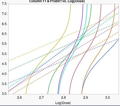

I generated independent probit regressions for multiple populations to a toxicant using a binomial general linear model with a probit link function and log(dose) as the X. Now I wish to convert my Y to probit units.
When I save formulae from the GLM output I get this formula for each population:
 Normal Distribution(Intercept+Slope*Log(dose))
Given that a probit is the inverse of the cumulative distribution function I was thinking to make a new column with the formula:
 (1) Normal Quantile(Normal Distribution(Intercept+Slope*Log(dose)))+5         *Note that the +5 is arbitrary
the output above seemed reasonable to me but I was confused to have both the normal quantile in addition to the normal dist in the equation and I would think that they would cancel each other and I decided to try the formula without the normal distribution as follows:
(2) Normal Quantile(Intercept+Slope*Log(dose)))+5
Once the  "normal distirbution" is removed, as in (2), It dramatically influences the shape. Moreover, you can see the the 50% lethal dose (5 probits) changes depending on the equation, which is really important
Dashed lines are equation(1) and solid are equation (2) for each population.
Did I convert to probits correctly in equation 1?  I have done a bit of research and have not seen mention of how to do this in JMP.
Thanks!

Sorry for being unclear in my initial question. I was trying to perform a probit transformation and convert the Y axis from a percentage (on the CDF of a normal distribuion: Φ(x)) into probits (the inverse of the CDF of a normal dist: Φ^-1(p)). See the snapshot from google below:
This is  important for visualizing dose response for mortality, because the lethality of a toxicant in a population is not normally distributed (it is lognormal REF). Traditionally, toxicologists would convert percentage mortality into probits (See the 1952 Finney probit chart) prior to making a simple regression by hand, because it linearized the dose-response relationship (easier without computers). In my analysis previously mentioned, I account for this by employing the use of the probit link function. But the output is not in probits because it is predicted percent on a CDF normal dist. It is my understanding that this is the optimal way to visualize and compare dose response relationships between populations.
I did manage to figure out how to transform the Y of the predicted formulae into probits for visual purposes using:
Normal Quantile((Normal Distribution(Intercept+Slope*Log(dose))))
I merely needed to add an extra set of parenthesis!! I am confident because it gives me the same median lethal dose and linearizes the line:
In the above graph, I added .5 to the aforementioned formula because 0 probits= 50% mortality and by adding .5 they would intersect at the same median lethal dose.
 You obviously know this stuff better than me, but I wanted to type it out to hopefully be of use to future users that might also want to transform the output into probits. Does this seem reasonable to you?
