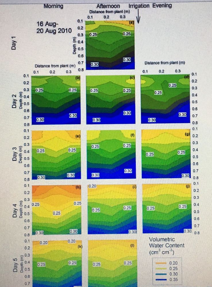

Please, I humbly ask for help on how to make a contour plot of the type I have attached. Contour plot_JMP.jpgContour plot_JMP.jpg

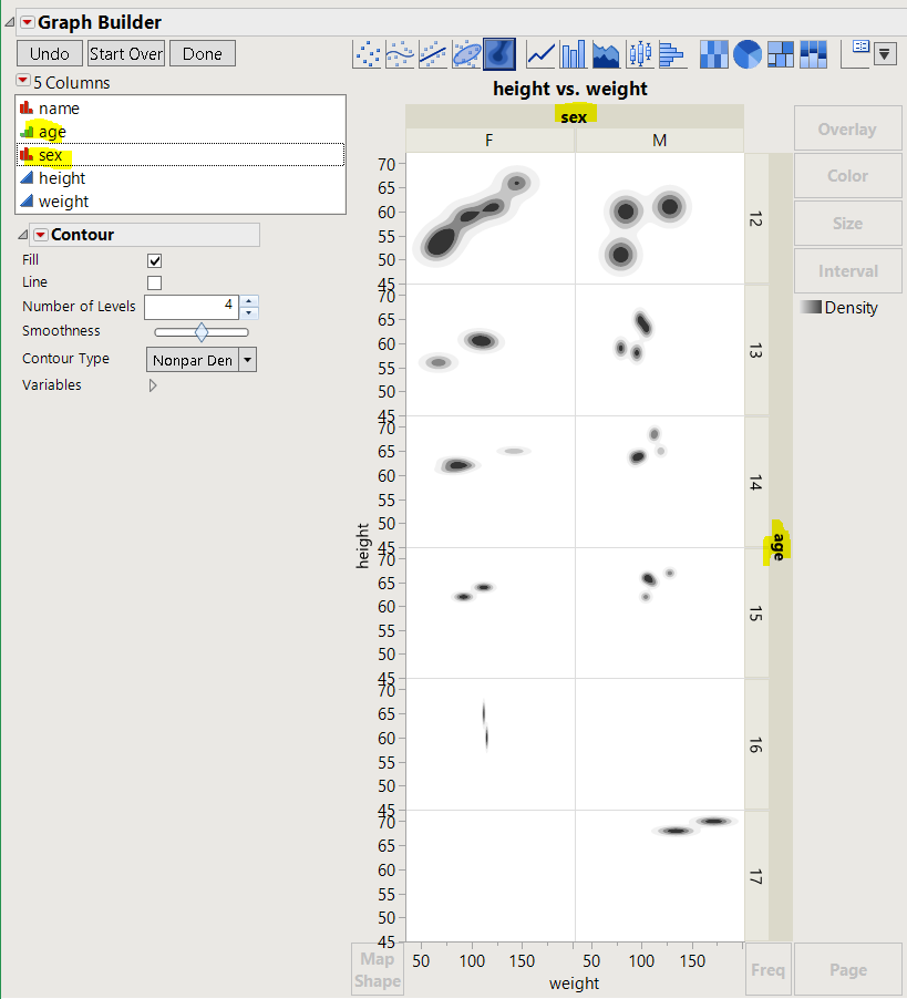

Craige_Hales
Re: Contour Plot
Graph Builder(
	Size( 400, 832 ),
	Variables( X( :weight ), Y( :height ), Group X( :sex ), Group Y( :age ) ),
	Elements( Contour( X, Y, Legend( 5 ) ) )
DragAndDrop height and weight first, then sex and age...may make it easier.DragAndDrop height and weight first, then sex and age...may make it easier.
Craige

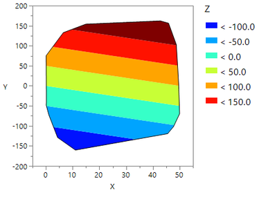

Thierry_S
Re: Contour Plot
Hi,
The best option is to use the Contour Plot platform under the Graph menu with your data organized as X, Y, and Z columns
Contour Plot(
	X( :X, :Y ),
	Y( :Z ),
	Show Data Points( 0 ),
	Fill Areas( 1 ),
	Label Contours( 0 ),
	Transform( "None" ),
	Color Theme( "Jet" ),
	Specify Contours( Min( -100 ), Max( 150 ), N( 6 ) ),
OUPUT:
Where Z = X + Y (as an example)
Best,
TS
