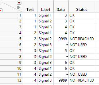

Or then you could stack the data. All columns which are to be stacked must have same data type, so change the not reached to 9999 before stacking. Then after stacking you could create a formula, which will tell what the issue was with the specific signal:
And then again use Column Properties if needed depending on what you are doing.

Re: Is there a possibilty to distinguish between two types of missing data?
Thanks. That seems to be doing quite nicely what I was looking for.
