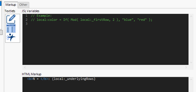

Could using Hover labels work?
Add rich text to hover labels

Yeah that works fine.  Is there documentation for all of the local variables?

I think this has at least quite many of them Work with the hover label execution context
