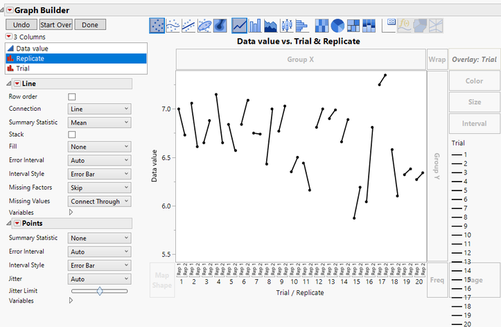

If you add a "Trial" column to your data table, then there are at least 2 ways to do this.
The Graph Builder can do it (it defaults to a separate color for each trial; I selected all, then broadcast a color change to black):

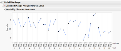

The Variability Chart in the 'Quality and Process' menu has this functionality built in.
I attached an updated copy of your data table with scripts saved for each method.
