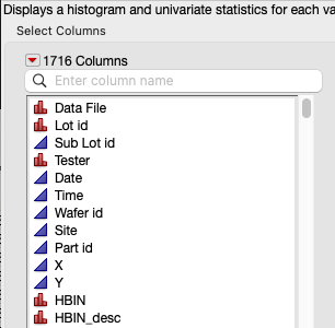

I have code here to create a custom launch window, as seen in the first image.  Is there a way to add a filter similar to what we normally see when we select analyze from menu?

Re: Adding a search field to custom launch window
The box with the Find / Search functionality is the Filter Col Selector.  Because it is a composite box it can be a little more challenging to script - you will find discussions on the Community that may help for common use cases, such as this one that describes how you can show the filter field by default.
Thanks Dan.  I got this code to work:
Panel Box( "Select Columns",
                 colListData = Filter Col Selector(dt),
                 colListData[IfBox(1)] << Set(1),
                 //colListData = Col List Box(all,<<set data type("Numeric"))
