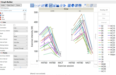

I'm trying to connect individual data points in a repeated measures in graph builder. Using row order, it seems it makes two lines (i.e. from the left box, one line to the middle and one line to the right box) I just want one connecting from left-middle-right!

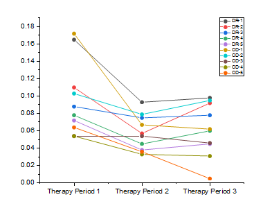

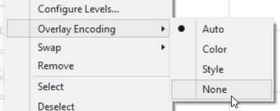

Using ID as overlay, it gets correct (Pic 2). But then I can't do the box plots correct? (Pic 3)

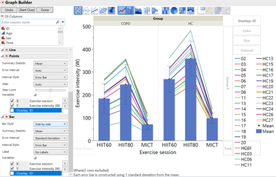

In my caase, putting ID as overlay gets me closer (and not using row order). Then, unclick overlay for those elements not needed; in this graph only for the line. But this messes up coloring (and one have to change every line individually?).
If i'm putting in a dot with meanSD instead of a bar chart, this messes up alignment..

The easiest trick:
Disable Overlay for any of the other plots, just use it for the line graph.
Bsisedes that, some plots can be fixed by setting Overlay Encoding to NONE
and using the Color Drop Zone  in addition to control the colors.
