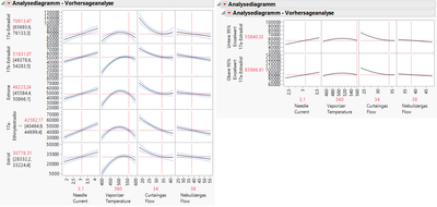

I have some issues concerning the evaluation of my results of a Design of Experiment which I conducted.
To Confirm my Response-surface-model, I conducted 6 confirmation runs. To check whether my model is able to describe the system I need it's confidence interval. But there is a problem. First I used the profiler in the prediction-model-window. But those values seemed to be to small, so I went on "Save Columns" and I saved the Formulas for "Individuals Confidence Formulas".
Using them in the prediction profiler graph, the results were different from those in the fit model window (See picture below) . How is that possible?
My second question is, what is the difference between the two formulas "Mean Confidence Limit Formula" und "Individual Confidence Limit Formula"?

I forget to say that on the left picture you see 5 responses, the first response is the one you also see on the right picture. Why are the Limits for 95%-Confidence-Intervall different?
Re: Confidence Intervall DOE
The confidence interval is for the mean response. The prediction or individual interval is wider because covers both the uncertainty in the mean and the error variance of the individual observations.
