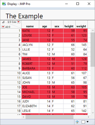

The way that I handle this is to use a New Data Box() function and to not use a Table Box(), but rather a data table.  With that, you can color the cells, etc. and take full advantage of all of the editing capabilities of a data table.
Here is a script to illustrate what I am talking about:

Nw=New Window("Display",
       V List Box(
              tb=Text Box("   The Example"),
              vlb=V List Box()
ndb = dt << New Data Box();
vlb << append(ndb);
ndb << close side panels(1);
tb << set font size(20);
It produces the following Display Window
