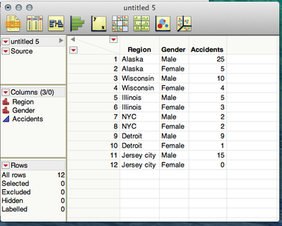

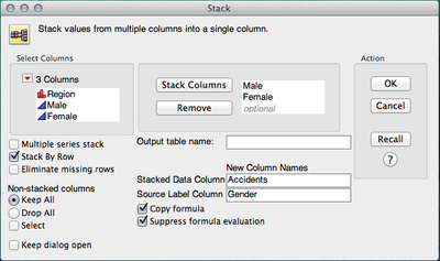

You need to use Tables -> Stack to get a data table similar to mine with a column for Region, Gender and Accidents. Then you can use Fit Y by X to get your analysis.
Start with your table and in the Stack dialog add the Male and Female columns to Stack Columns and then name the Stacked Data Column "Accidents" and the Source Label Column "Gender".
You'll get a table like this.

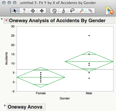

Then you can use Fit Y by X with Gender as your X and Accidents as your Y.
You'll find the analysis options under the Red Triangle at the top.

With that layout you can try the Matched Pairs analysis platform (Add Male and Female columns as Y). However, you'll have more options if you stack the columns (Stack in Tables menu). Then you can use the Fit Y by X platform to compare means with Gender as X and the count data as Y. The variance appears higher for for males so you may want to look at a nonparametric method which are found in the red triangle menu in the Fit Y by X results window.

Jeff_Perkinson
Community Manager Community Manager
Re: Comparing means for implicit data in JMP
Hi Mike,
