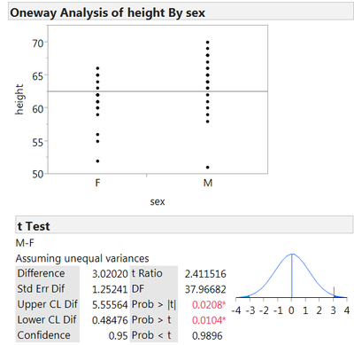

Agree with Tom -- switching value ordering in the column properties will get you what you want. But that's not strictly necessary -- the t-test you want is probably already there. I ran a t-test on the Big Class sample data set, using Fit Y by X. (Y=height, X=sex).
The two tailed p-value is .0208.
The one-tailed p-value for the null hypothesis that females are taller than males is .0104.
The one-tailed p-value for the null hypothesis that males are taller than females is .9896.
Reject the hypothesis that females are taller than males.
