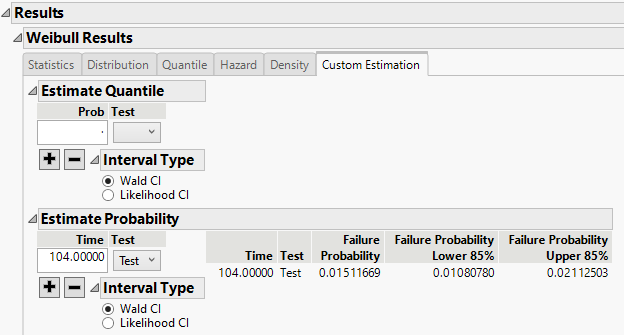

However, within the Weibull Results, I want to use the Custom Estimation to give an Estimate Probability combined data table at a specific time.
As I want to script this analysis for repeated use, I saved the script from the combined data table in an attempt to use it.
However when I try it, it provides only an empty table with column names.
The same thing happens when I try to save the Statistics Estimates (alpha, beta, etc.) as a combined data table.
Any suggestions are welcome.

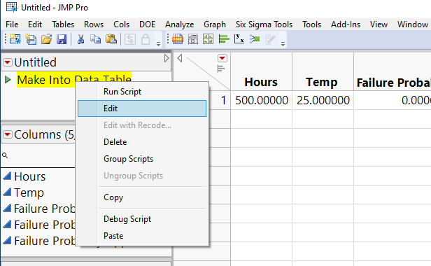

Instead of the red triangle, try right-clicking on the green triangle and choose "Edit":
Then you can copy and paste that script into a new script window for automation.
4 REPLIES 4
Re: Combined data table scripting
I think you may have grabbed the wrong script. What you posted above looks like the table script obtained from the red triangle of the new table. Instead, try grabbing the script called "Make Combined Data Table" -- right click on the script name or the green triangle, and choose edit. If you copy and rerun that script, I believe you'll get the result you desire.
Additionally, it might be better for you to use "Make Into Data Table" rather than "Make Combined Data Table". It looks like you only want to extract the results from a single output section.
