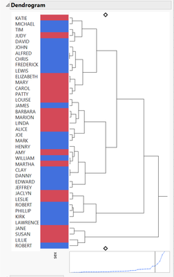

Hello everybody,
I would like to know how to display the legend associated with the option "More Color Map Columns" from the Hierarchical Clustering report.
Here is a very basic example using the BigClass table. I launch the clustering using height and weight and I select sex as Map Column. How can I know that red is associated with F and blue with M?
Thanks in advance for your help!
2 REPLIES 2
Re: Hierarchical Clustering: how to display the legend associated with the option "More Color Map Columns"
You can hover over any cell in the color map to see which level the cell's color corresponds to. If you specifically need to display a legend, though, I don't believe this is possible outside of scripting one manually. Consider adding this to the Wish List.

Hello @Ross_Metusalem and thank you for your answer.
I will indeed follow your suggestion and add an item to the Wish list!
