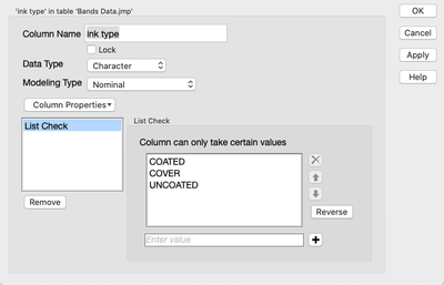

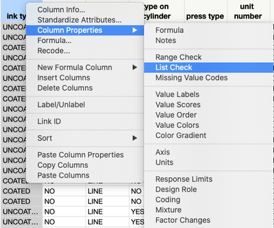

The List Check property is what you're looking for.

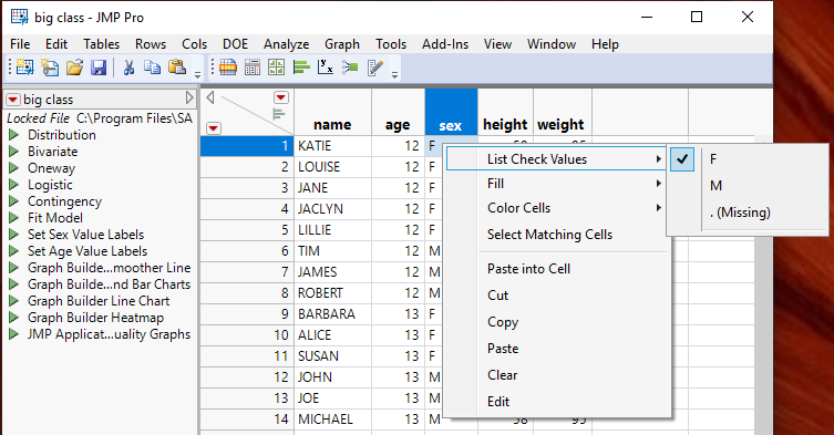

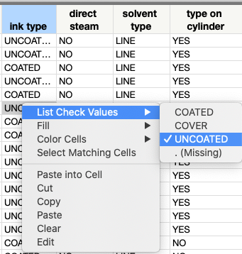

If you set the "List Check" column property for the columns in question, you can right click on a given cell and see the Approved values and select the value one wants.

Thank you. I came across "list check" before, but missed the "add a value" txt box beneath the box where it aggregates all the values. Since I was not able to enter the values there, I was not sure, Thanks for your clarification
