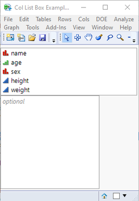

is this what you are talking about
This example comes from the scripting guide for Col List Box()
Names Default To Here( 1 );
New Window( "Col List Box Example",
	Col List Box( all, width( 250 ), maxSelected( 1 ) ),
	fontobj = lb = Col List Box()
Jim

Thanks for the quick reply Jim,
Close but not quite, looking for this:
