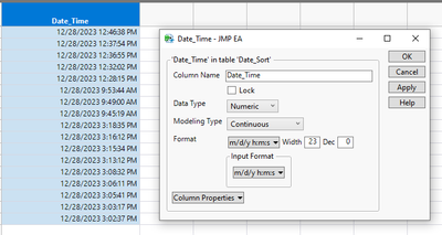

I apologize because I see this question asked in other ways before but I can't seem to follow the solutions. Perhaps my date format is different enough and I'm not keen enough on scripting yet to figure out where I'm going wrong. I'm using JMP 17.
I've attached a simple table where you will see a column of Dates that looks like a correct format but JMP only recognizes it as character. I can change to numeric but when attempt to make it a m/d/y h:m type format then it reverts back to character.  As a result I cannot get the column to sort properly.
How do I script this to modify from char to numeric m/d/y h:m type format?

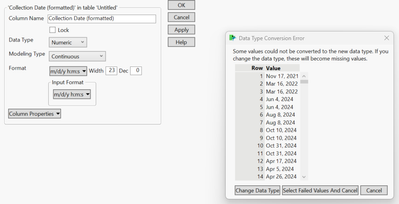

Re: Character Date to numeric date
Mine are still not working. This is what I see:
txnelson
my suggestion is to create a new character column
Set the formula in the new column to
:collection date(formatted)
Then remove the formula from the new column.  You can do this in the Col Info window.  Double click on the column header of the new column and it will open the Col Info window.  Click on the formula column property, and then click on Remove
Now attempt to change the new column into a numeric date/time value.  It will give you the same warning message.  Go ahead and convert the data.  Then compare your original column, Collection Date(formatted) to the new column, and see what values are different.  That should give you a clue as to what the issue is with the conversion method you are using.
