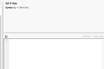

Add-On questions:
  • Is Graph Box a Display Box - where can I find it in the Scripting Index?
  • How can I activate the documentation for Set X Axis?

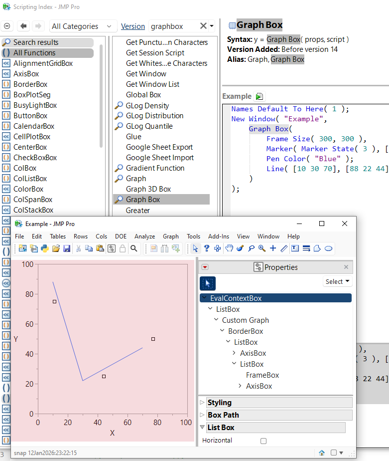

Craige_Hales
Re: Changing the scales of a graph box
GraphBox() is a function that returns a more complicated nest of display boxes than the other xxxBox() functions.
Craige

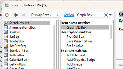

I mean, in analogy to a Graph Builder Box, which is generated by Graph Builder().
The recipient of << set X Axis()is a  "Custom Box"?
In the  Scripting Index, Custom Box doesn't know a message << set X Axis():
OwnerBox?
Craige_Hales
Yes, I saw that too. The OwnerBox is a very thin wrapper box used to attach a scriptable interface (with commands in addition to the scripting a box normally has.) My quick test did not convince me that the custombox was that scriptable interface. Probably it just forwards some commands to the appropriate grandchild box.
