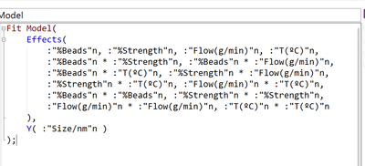

The model will follow along what the 'Model' script in the data table follows. So if I take the example from "Mill DOE" in the sample data folder:

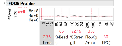

That makes the terms in the FDOE follow (Ie flow is quadratic)

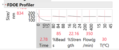

If I change the term (ie remove the Flow x Flow term) then it will change (see how 'Flow' is now linear), so in your case, go to the 'Model' and make everything linear.
